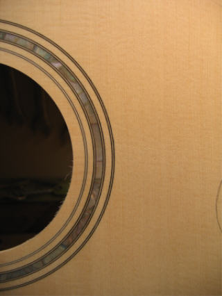

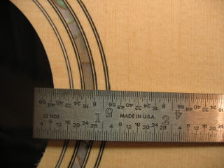

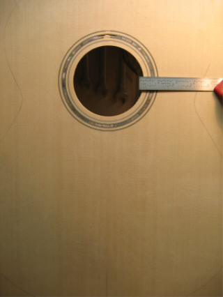

I took these pictures of a top I am working on with the rosette installed. This a typical 'AAA' set. I hope there is enough detail to see the wood. It is difficult to photo quality spruce because there is no funky figure to show off!
I hope enough detail shows through to get an idea of the wood.

I bought some from Shane and will concure with him that it is very nice stiff wood, His AAA compares with any other I've seen and nicer than much (nicer than some wood I've seen people try to sell as Master) so I am looking forward to when he finds his "Master grade wood. As far as the look of the wood goes I would say that it is much lighter than sitka although it has some of those pink colours in it. To my eye it looks like the wite spruce we have here in Northern Ontario but of course, I've never seen a spruce around here big enough for a guitar top. Building my first guitar with it now and am looking forward to comparing it to the Sitka and Red spruce I ussually use. So far it looks very promising.

Thank you Shane for the nice pictures. The wood tops look really great.
I appreciate you taking time to do the photos.
